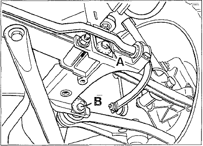

The rear tires of my 2002 C4 cab tip have worn on the inside. I have had them replaced and a 4-wheel alignment done. The technician said he could not do the rear adjustment as he could not get his spanner on the relevant nut! He said there may be a Porsche special tool or a "knack".
Anybody any experience of this, or how it can be done. i am not sure whether he was trying to adjust toe or camber.
On the rear the kinematic toe-in is not adjustable. Camber and toe can be adjusted via eccentrics. A adjusts toe and B adjusts camber.
Tool B (Porsche tool 9626) below is used to get at the right angle for the rear eccentrics.
