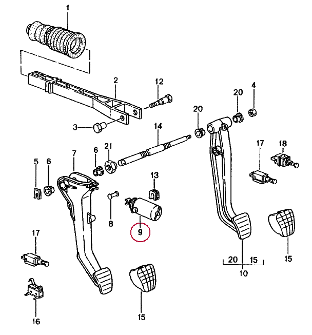

Does the clutch spring have a top cover around the hole where its piston goes? If so could this be out of place getting in the way of the piston?
Porsche changed the clutch (pedal) spring at least four times as I recall. Your MY03 should have either the last one or next to last one.
Look for binding either on the pedal shaft or the spring mechanism. You can disconnect the spring and see if that is the problem.
