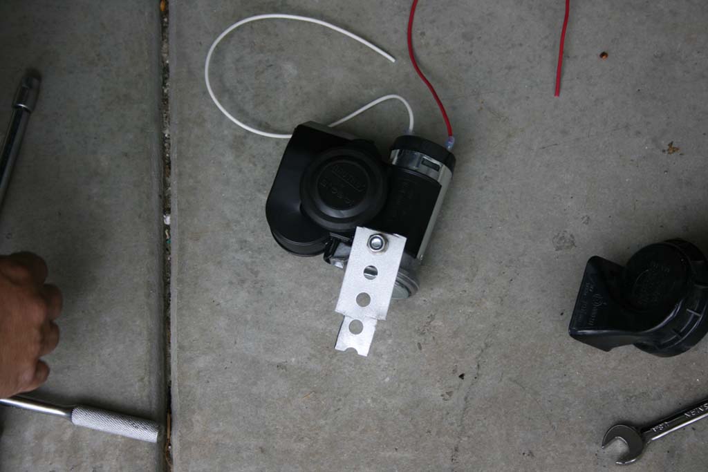

I would put in an aftermarket horn like the Griots.
Fairly simple to wire in and use the existing relay and fuse.

Chances are one of the vehicle horns is bad. My would replace both or put in an air horn like I did. :D
LOL! I think I will pass on the air horn Loren. I guess I just assumed (you know what they say about assume) that the alarm horn was the high frequency horn from the steering wheel.
Thanks for setting me straight. On second thought, maybe the air horn is not a bad idea :P

Loren, Can you install the Griot's Air Horn in the same location even with a 3rd radiator?
Yes, it is above the third radiator in my car.

The 25A fuse seemed plenty enough. There were two horns - now you have one (albeit louder).
So I used the original wiring and skipped the extra relay.
