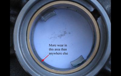

the 2nd rebulid I suspect and I need to verify is that the Hub is about 2 mm shorter that what it suppose to be
I backup my claim for the reason below see pix
connected to each other looks like this
so if you look at the arrow the dark area represents how much engagement between the tc hub and front pump gear
and it suppose to be all the way as shown in the 2nd pix lower right
next pix shows how front pump and tc hub mated
the gap did something that created the uneven wear of bushing see pix below
hub length according to the website below is suppose to be 44.65mm see pix
