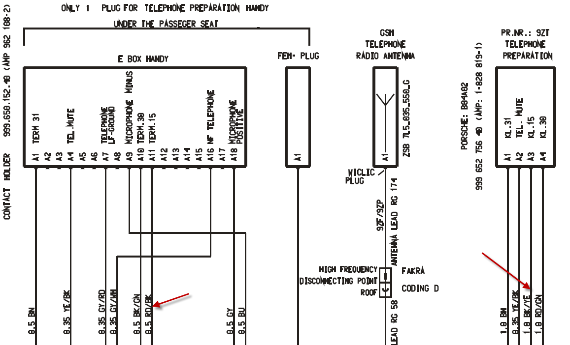

Try looking for the telephone prep wires under the passenger seat.
Depending on which telephone prep option you have it will be either Red/Black or Black/Yellow. Brown is ground. These are switched power.
Should be easy enough to test with a volt meter.
Terminal 15 is switched +12 volts
Terminal 31 is ground
Terminal 30 is unswitched +12 volts
