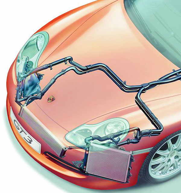

Installing the third radiator on a non aero '00 996, so far so good. But the driver side hose (the small hose to the new radiator) seems way too long. Did anyone have to cut this? Perhaps it's installed incorrectly. The pass side hose seems a little short too.

I added a cooling diagram to my DIY page last week that hopefully illustrates the hose path a little better (I could not get a photo because there was not enough light to see it).

Much thanks to Loren on his DIY tips. I finally finished the install, what a *****. It was a hell of a job in my hot Houston garage. I ended up having to trim the driver side hose a little to get it to fit correctly. I was a little bummed about that, but there didn't seem to bve any other way, i was only about 3". did anyone else have to do this?? Did I screw it up? Seems to be working fine so far.
