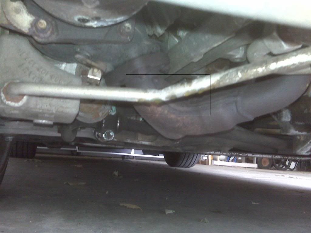

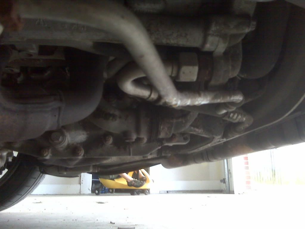

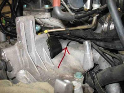

Any guess what this leak is from:
I believe that pipe is the left intake pipe that is coming from the drivers side oil collection container.
The fluid does not look or feel like oil. I am headed to the track in a few day and wondering if I should take care of this first.
I agree with Loren that it's coolant. First place to look would be the water pump and you need to get it sorted before heading to the track.
Looks like coolant to me.
Check the hoses and water pump and of course the coolant tank cap.
Thanks Loren and wvicary

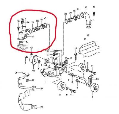

Take a look on the top of the engine , left side. If there is fluid take a look at the seal on the picture. I saw a leak lately on a turbo and replacement of a o-ring on this part was needed..

Thanks for the info and diagram. Tremendous help all of you. I will let you know what it turns out to be. I am running out of time before the next track day and forced to drop it of at the dealer in the morning. Hopfully covered by warranty, but needs to be fixed regardless. Would hate to get stranded at the track or worse not be able to run - or put someone else in danger cause of a fluid spill on the track.
