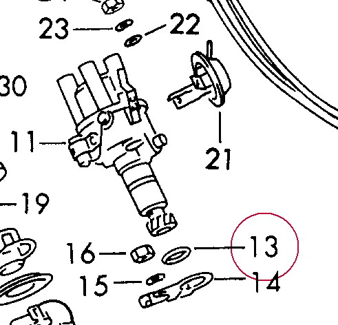

Hi, Thanks for the reply. Yes the O ring is there. That area is bone dry. The oil is coming up the shaft into the dist. I'm going to take it apart today and see what's inside. The parts book seems to show two bushings and some other unidentified part between them.

There is nothing between the bushings in the housing but in some Bosch Dist there is a radial seal on the upper end of the housing.
