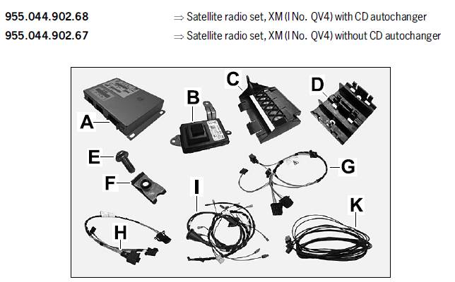

What sub part numbers are included with the XM Satellite Radio Add on Codes 955 044 902 68 and 955 044 902 67, with and without cd changers respectively?
Are there brackets and wire harnesses included in these? The reason I ask is because I bought the reciever (part no 7L5 910 563 E) and this is all I am getting. I was told this came from an 08 and I would like to add it onto my 08. I do not have a cd changer so I am hoping this will work with mine. I am thinking I will need a bracket and wire harness.

Yes, you are correct.
One of the benefits of being a Contributing Member here is viewing the Porsche TSBs. This image is from the 14 page TSB Satellite Radio Installation Instructions (I No. QV4).
Thanks! I should do that! Are parts B through K needed for the case of no cd changer? Do you have parts list for items B through K? Also the installation instructions?
