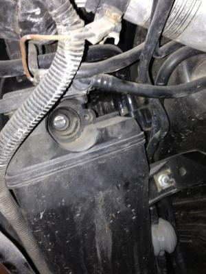

I finally decided to take care of the problem. I removed the wheel lining to access the evaporative canister and wham! I am missing the WHOLE valve and the wiring...
post-46998-0-09109500-1351624869_thumb.j
I ordered the valve but could not find a a loose cable to insert.
Where should I start looking? Where is the valve connected?
