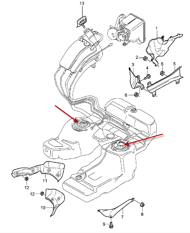

did not change the pumps yet . Now when you start the car it runs only for about 10 to 20 seconds . When i am under the car i can hear the pump running (passenger side) , then the pump stops and 5 second after that the engine shots down. Any help before i send it to dealer ? :renntech:
