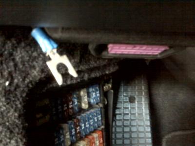

and i found a wire hanging out of the fuse box what is that ?
Edited by fredkhaz
wow it was the blue wire.
i guess car had a kill switch before and been bypassed and that ground blue wire came loose.
i feel stupid. lol
