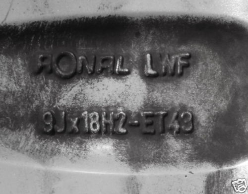

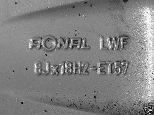

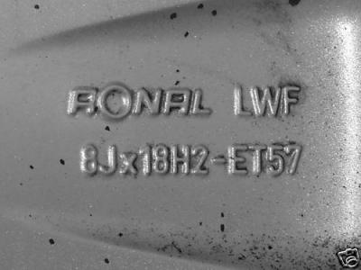

Here is an example of where the offset is stamped into the inside surface of the wheel:
This is an OEM wheel, 8 inches wide by 18 inches diameter, and an offset of 57mm
This one is also OEM, 9 inches wide by 18 inches diameter, and an offset of 43mm
Yours should have similar markings, but you may have to clean off brake dust and road grime to get a good look.

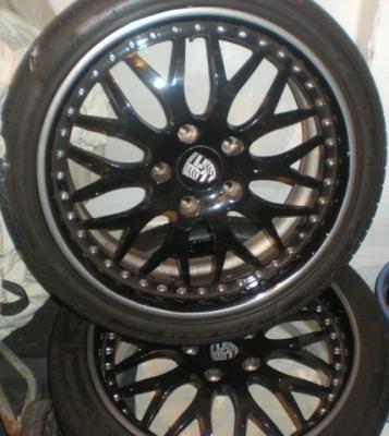

Oddly enough, I got tired of staring at them today. Called the guy who sold em to me. He told me his car is a '02 carrera 4 and he had the spacers up front and nothing in the rear. So for sh!ts and giggles I test fit them and went for a slow spin, zero rubbing
The wheels are 245/35/19x8 fronts and rears are 275/35/19x10.

Do you have a pic please with them on the car.
Shoping for wheels too.
Tx
S
here it is
This is how it looked when I bought it
These are the wheels off the car
This what the car looks like with the rims on the car
Edited by GTA_G20
