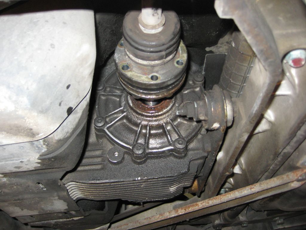

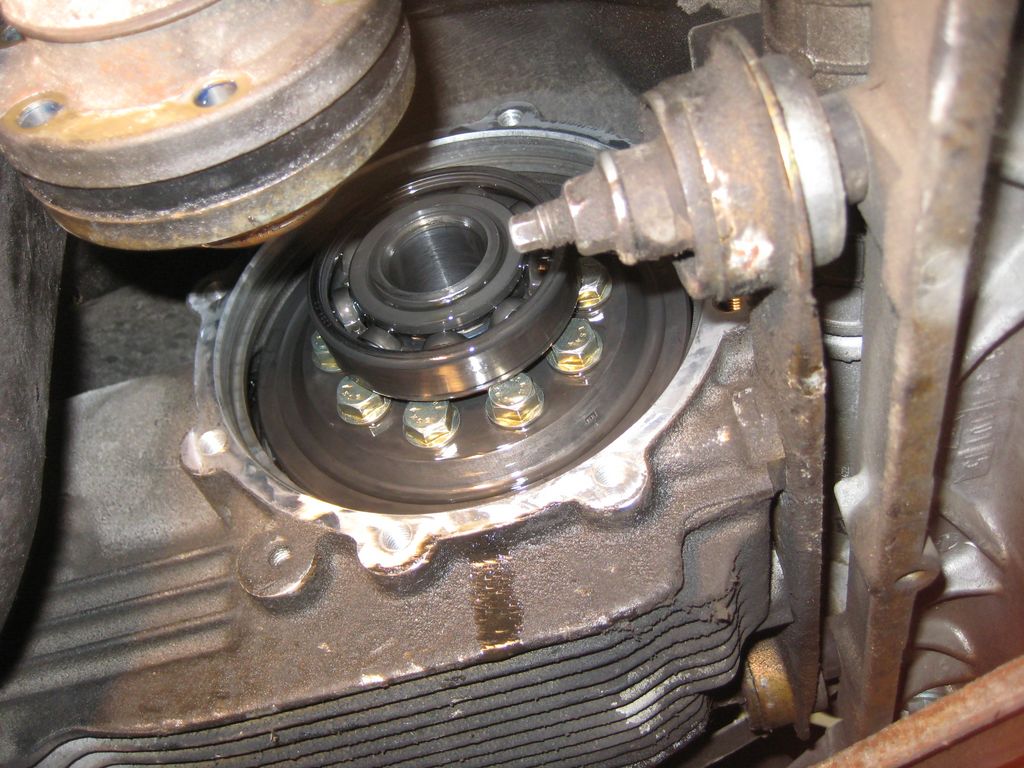

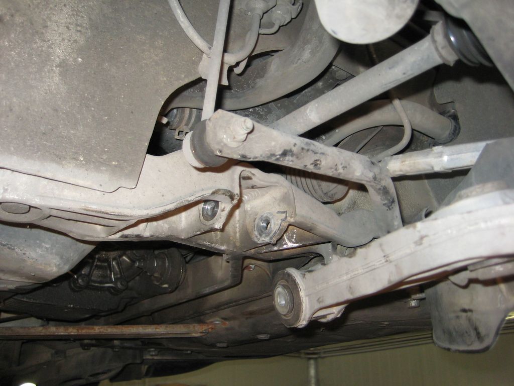

Ok, lift up the car, dry out the diff oil, remove the lower wheel arm and try to get enough room space to pul out the joint
Take out also the 6 screws and nuts fixing the last part of the joint
Now you have enough space to remove all the screws and the dif cover

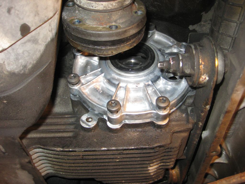

Clean everything, put the new Oil seal and remount the cover.
Now fill with transmission oil to the level (until oil start to come out from the filling hole) and remount everything in reverse order. you are done!

I had to change it because of the oil leak...
