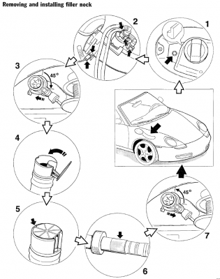

I got the canister off thank you but now I cannot remove the fender because the fuel filler assembly seems to be holding it. Can you help with instructions for removing this please.

Thanks Bill -- too early - I misread. :blush:
Detach negative terminal of battery and cover the terminal or battery.
Remove right front wheel. Remove right front wheel housing liner.
1. Detach filler neck. Remove cap. Undo hexagon-head bolt. Unclip seal.
2. Detach fuel lines and ground strap. Press release buttons and simultaneously pull the lines apart. Pull off the ground strap.
3. Remove filler neck. urn the filler neck clockwise by approx. 45° and pull out carefully. The open surge flap must not be damaged when pulling out the filler neck.
Install
1. Close the surge flap. Close the surge flap before fitting the filler neck. Engage surge flap at the locking lug.
2. To facilitate installation, apply a thin coat of engine oil on the indicated area (arrow).
3. Carefully push the filler neck into take-up flange on the fuel tank. Turn the filler neck anticlockwise by approx. 45°. Fit fuel lines and ground strap Fit seal in correct position. Ensure that the locking tabs are seated correctly. Fasten the hexagon-head bolt. Coat seat of the cap seal with Vaseline.
