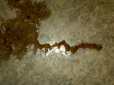

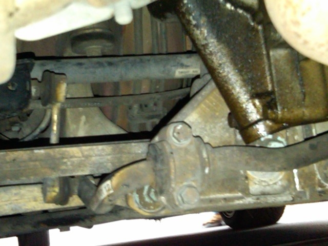

I seem to have developed a mysterious leak just inside and behind the wheels. A small leak just inside and behind the left wheel, and a small leak just inside and behind the right wheel. I can't locate the source and the liquid that leaks is a brownish red color and has an oily consistency.
I know that the popular answer for engine compartment leaks is the coolant (I did just replace the expansion tank, cap, etc.) COuld it be coolant picking up grim and oil from the engine? Brownish red sounds like either oil or, I hesitate to say, transmission fluid. THe oil level doesn't seem low, and I don't know how to check the transmission level.
I have attached some photos of where it looks like it is leaking from and the leak itself on the concrete. I would appreciate any ideas you all have.
Best thing to do is to clean off everything you see - then take the car for a short test drive and then inspect to find the origin.
I will give it a shot. I have an appointment with the dealer next week, and was hoping to have some idea what it might be just to filter out the BS if there is somethiing simply I can do to narrow it down. Sounds like it isn't anything you all have seen before. Thanks for looking

Your pic looks like oil on the floor.
If you remove the access panels underneath 996 you will get a unique view unlike past 911s .
It should all look like new underneath when you remove the access panels. Any wet areas will be easily identified.
Hard to remove them if in a hurry, otherwise start at the back, the aft panel will probably give you (tech) access to what are looking for.
