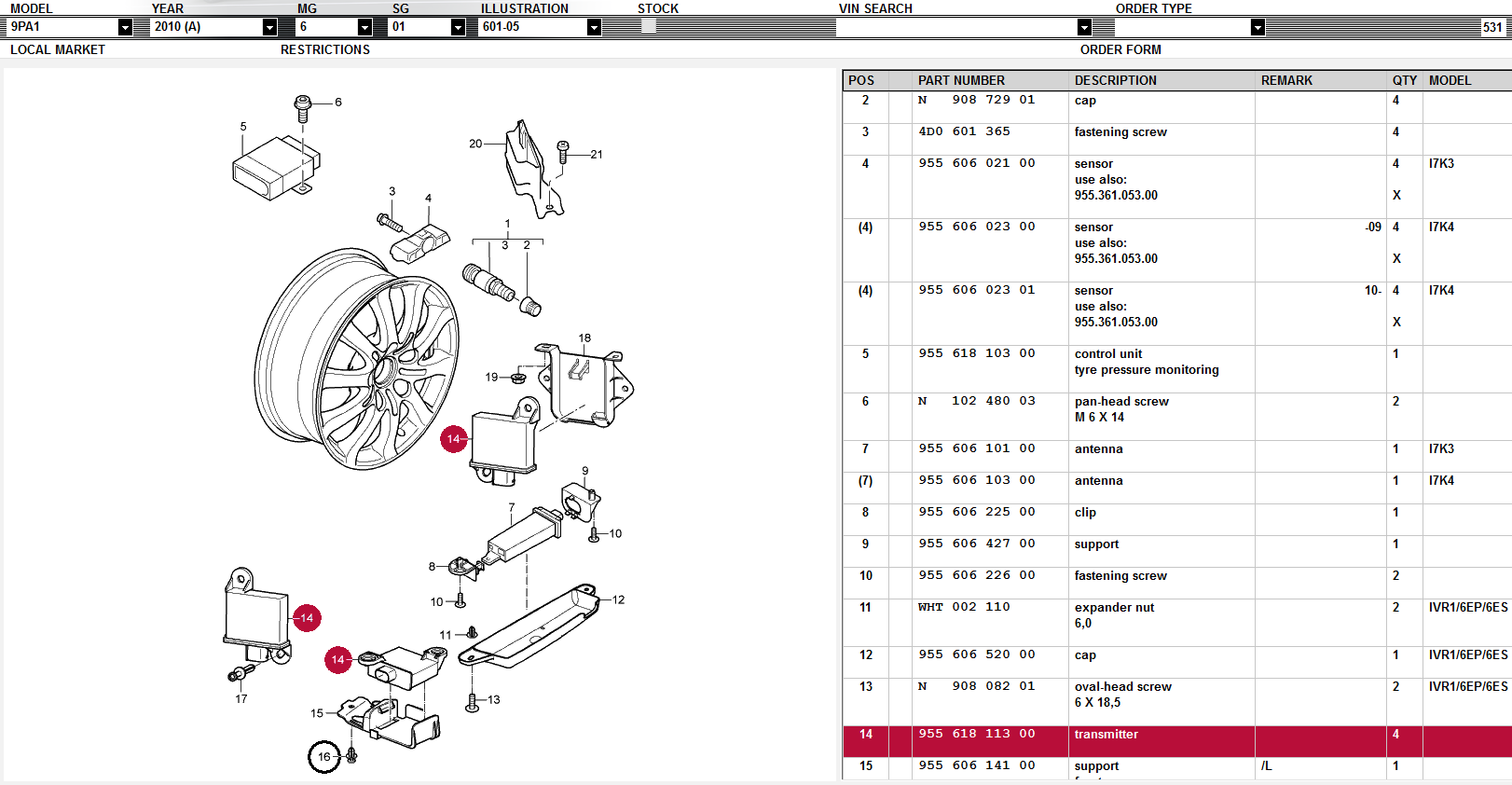

There are only 4 transmitters in the car according to PET. So I don't think a 5th sensor will be seen.
Actually, I'm pretty sure that the units in the wheels (now 5) are the transmitters and the car has four receivers - one near each wheel well. The Porsche Regional Tech seemed to think that 5 transmitters would confuse the 4 receivers; but it doesn't look like the one in the rear mounted spare is close enough to either of the rear receivers to be picked up.
So far the system is working flawlessly with 5 senders. It was throwing an error signal when it could only see 3 senders in the wheels - none in the RF.
