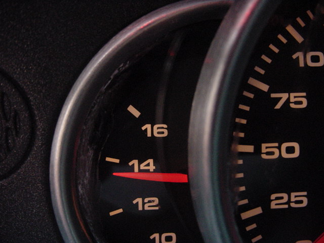

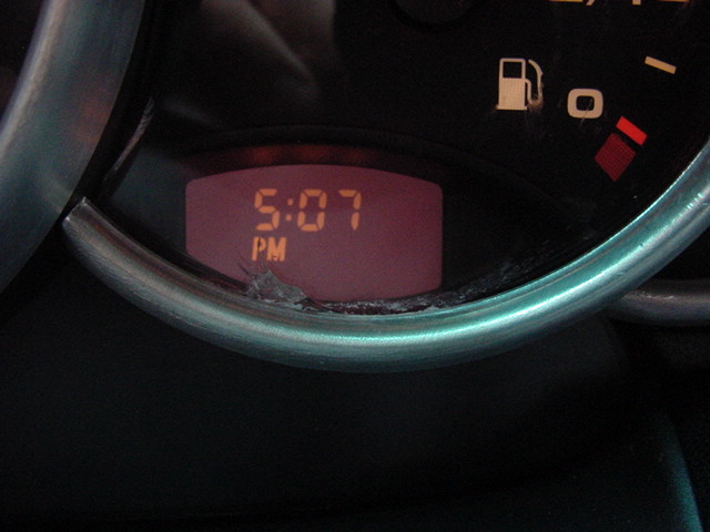

I was installing my new alu. instrument rings last night and as I was putting what I taught was silicone to attach the rings, my fingers got stuck together. Guess what it was not silicone it was superglue. Well some of the super glue went on the gauges clear face. How do I remove super glue from the gauges plastic face.

Nothing will get it off. Sorry but sounds like a new instrument cluster is
the only way. Not sure if you can even replace individual pieces of it.
Luckily they go quite cheap on ebay.
Can I replace only the plastic individual pieces of the cluster? If I can I need the part number. :oops:
Are the overlay metal trim rings on/glued to the cluster face?
Or did you pull them off when you realized what happened?
Yes the overlay metal trims are glued on. :help:
I have been looking for a cheap 996 cluster to put on my Boxster for a long time so I can have the extra 2 gauges. :P
The front face of the cluster can be removed, but Porsche does not sell a replacement part and neither does VDO.
You can pry the original plastic trim rings off to replace the clear plastic lense, but when the overlay is already glued on, I have never tried to do that.
If the front face is removed from the cluster then you can pull out all the clear plastic lenses from the back, which will end up damaged since the are also glued in place, but you do not care since the have glue on them. Then find a plastic shop make new lenses of the most thin plastic they have.
My frank suggestion, since you used super glue and not silicon or tape, is to ask a local speedometer shop if they can fix the damage.
I had the same problem last week--however, I managed to clean the dials by scrubbing them with a fine metal polish (I used Flitz, but I think any paste like silver polish should work). Don't give up yet, you might be able to save your dials!
You may be able to remove the glue with a polish as suggested - some final acrylic/plastics type buffing may be required to get a clear finish though.
Tip for next time - I prefer to use some thin double sided tape in a few small strategic locations (you do not need too much tape) around the inner perimeter of the rings to atttach them to the cluster - much safer and this method permits easy removal if required.
