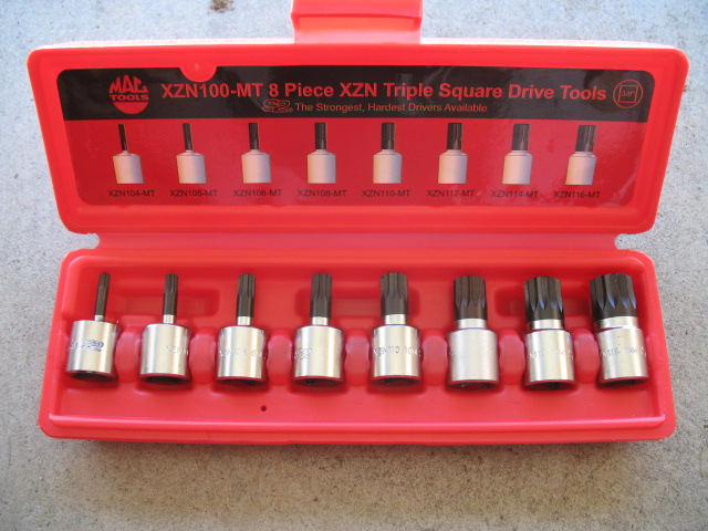

I am in the proces of removing my transmission as well. The bolt on my 1997 5 speed is a 10MM triple square also known as a ZXN socket. I bought one at NAPA...
It looks like a torx, but has 12 points instead of 6 points...
