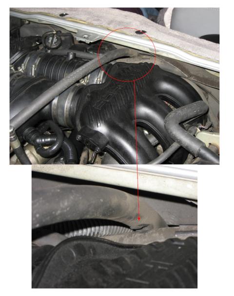

The "hose" in your pic. is the shift cable (Tiptronic). Take a look if the material under the foam protection is still in good shape, if yes, you can use the cable even for a long time.
The cable makes a mechanical connection between the gear box selector and the inside gear shift lever (P-RND etc.)
The topic you indicate discusses a hydraulic/electronic problem which is not related to the shift cable.
