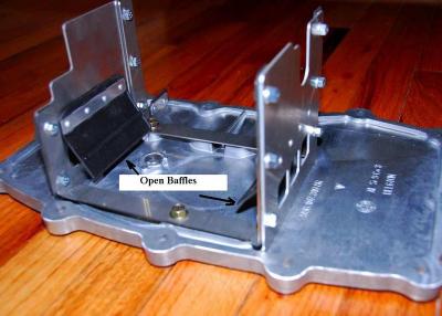

Are you sure it was an X51 baffle - did it have flaps?
The stock baffle looks similar stock on left -- X51 on right.
(sorry can't remember where I got these images)

That's it.
I remember clearly 'cause I was rushing to get it done before a track event, and spilled my drained oil all over the garage. :angry: Then found it was already installed!!
