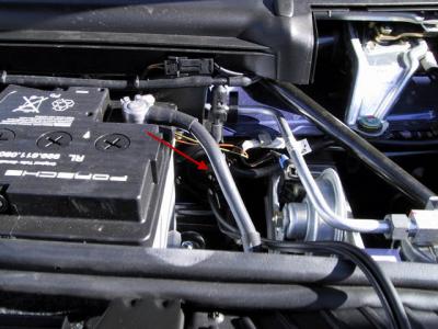

Behind this device, there is a 2nd rubber grommet (see next picture) that seems to allow the passage of wires to the battery bay. The grommet is visable on the battery compartment side, but covered on the front cowl side. There is a small amout of space between this device and the back wall of the cowl (@ 6 mm). I am thinking that I could make a hole in the grommet and thread a metal hanger-like wire to pull the other wires through. It seems it would be easier to move this device (not sure how to). There were 2 large screws up top that I took off, but it still sits solid. Any ideas?
Here is an image of the grommet on the battery compartment side (this is located in fron of the battery on the passenger side of the car.
The from of this grommet is blocked by the black plastic box seen in the other pictures.

(photo courtesy Tom Morris)
Still a little hard to see even with the arrow bout the CD Changer wires pass through here.
Loren,
Is this roughly where the CD changer wires pass through on a 996? I am assuming that this is a pic of a 997...
Thanks!
Loren,
Thanks!
Yes, there is a rubber grommet between the battery and the firewall (above the accelerator pedal inside).
