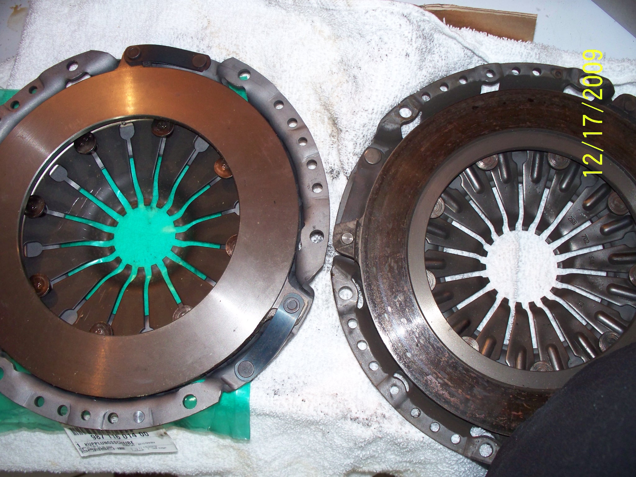

Bought a clutch kit from Sunset and it is siqnificantly wider than existing one in car. Original is 1-1/8" and new one is 1-5/8" wide.
Pressure plate is also wider than original. Also the springs on the pressure plate appear to be thicker and fewer. Overall diameter is the same.
I assume it is an upgraded version? clutch disc is part number 987 116 014 00...comments?
I was at The Rennshop today and we looked at your pictures. Marvin said what you think is the original clutch looks like a Sachs replacement.
I have a 1997 owned for 10 years and Marvin replaced my clutch last year with a Sachs replacement. I saved my original parts and when I returned home to look, they do look a bit different than what you think is the original. So the clutch you are replacing may not be the original.
Yes the one in the car is (was) a Sachs clutch. New one came in a Porsche box from Sunset. Not a sachs...pressure plate springs are considerably stronger than sachs one that was in the car.
