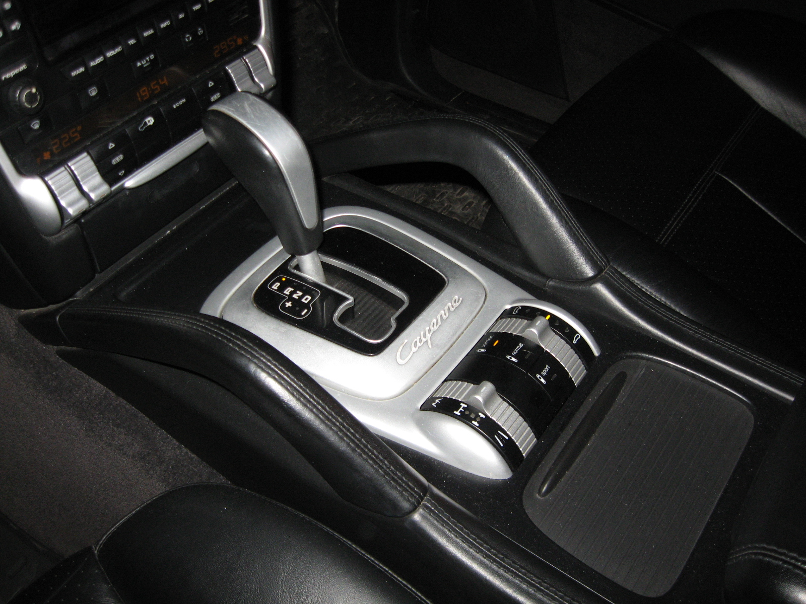

That switch goes through several stages. First is to go into low gear in the Transfer Case; and your transmission should be in Neutral to make this switch.. Second is to lock the center diff. There is no front diff. Third, only if you have the off road technology option, is to lock the rear diff. Also, if you have the air suspension, you might want to raise the car to the highest level.
Yes I got the pneumatic suspension, I don't know what is this off road technology, If I play with the switch it says something like: Locked front (sorry Center maybe), locked etc... on the display.
How do I go into "low gear on the tranfer case" ?
This is a picture of the switches on my car (for pneumatic susp, shocks and 4wd) :

Hi -- the manual does a great job explaining all the off road options and respective switch settings. If you do not have the paper/original manual then become a contributing member here and you can download a PDF Cayenne manual. For instructions on how to become a contributing member click on the "donate" button below and you are all set. It was the best money I ever spent to help me understand and maintain my Cayenne S (2004).
