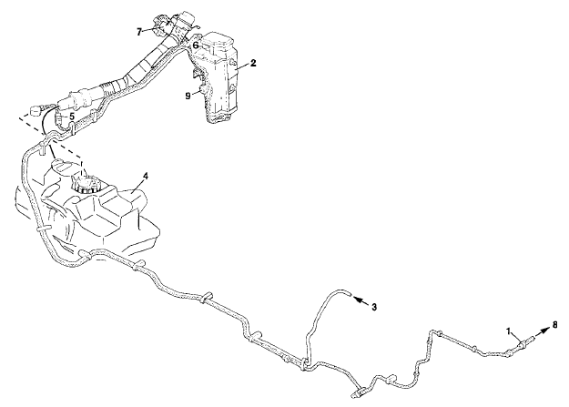

P0446 EVAP Canister Shutoff Valve (Function) - Below Lower Limit
Possible fault causes:
Fault area
- Purge air line blocked.
- Flow resistance of EVAP canister too high.
1 - EVAP canister purge valve
2 - EVAP canister
3 - Purge air
4 - Tank
5 - Pressure sensor
6 - Shutoff valve
7 - Operating purge valve
8 - To intake manifold
9 - Vacuum control valve
