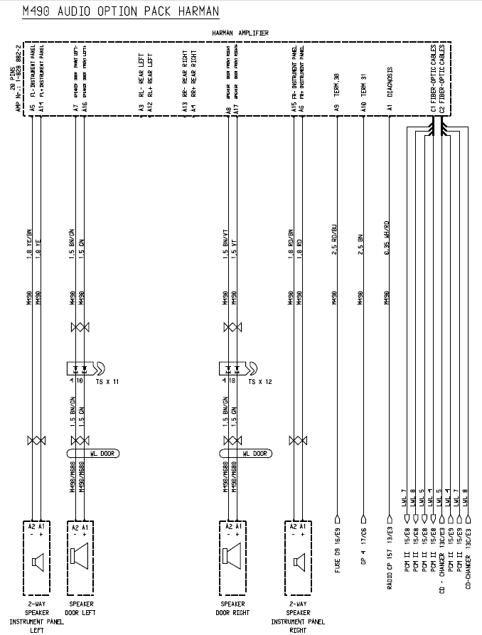

Man you are quick! Thanks! I think the pinout is the same, but my amplifier is a Becker. And yes I am sure it is a 490 because I see it listed on the option sticker in the front trunk and the sticker on the amp says Becker. I was looking for the wire colors for the rear speakers. Two reds, black and brown, at this point I am just not sure which are left and which are right. But armed with this information I should be able to figure it out. Thanks again.
David
Loren,
David
Not an original 2003 amp then. 2003 was Harman and BOSE and both were on the fiber network (MOST).
