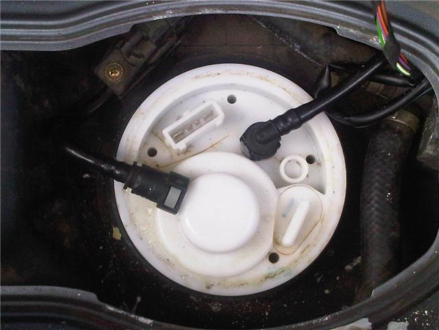

My 03 Boxster S has a gas leak at the sending unit. I remember reading a post in here about some sort of sealant that can be used to fix cracks in gas tanks and such. I think Toolpants wrote about????? I would replace the sending unit but I already did that and this one from Pelican parts only lasted about 3 months. I don't feel like going through the pull out and replace again. Does anyone know what a good gas sealant is????

Don't remember if it was 02 or 03 when they changed the design. The 03 has no return line, there is a pressure line coming out the top of the tank that goes to the engine with the fuel flow meter mounted right there on the tank. When mine leaked I got a puddle of fuel on top of the sender that I most noticed when backing into a parking space because the fans would blow the smell from under the car.

I don't know that I'd try to seal one, mine was cracked around the outlet where it makes the 90 degree bend. Is yours cracking in the same place?
The larger port on the left is the outlet, mine cracked in a circular ring around the outlet. The hose to the right is the vent to the cannister for fumes and vents. If you notice the pump outlet makes a sharp turn then goes through the transducer for fuel flow. There may be strain in the pump housing from vibration causeing the cracks. I think mine had velcro or something to retain the transducer. Also, how tight did you tighten the lock ring? When I did mine the ring was finger tight, and I tightened it much tighter, I think the spec is 30 ft pounds or simillar.
The fuel pressure regulator is part of the sender unit, so there is no return line. I think mine failed because I filled it to the rim on a warm day, and the next day it started leaking. Do you stop yours when it first cliecks? Or fill it to the rim?
I never add any more fuel once the gas stops on its own. I tightened mine fairly tight using a screw driver and hammer to tighten it. I could have gone tighter but once I felt it was snug enough not to leak I left it alone. I'm still not sure what would have caused this part to fail so soon.
