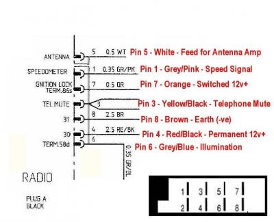

First, the unit doesn't recognize the difference between day and night. I assume this has to do with improper connection of the illumination wire (or lack thereof). Where should I wire the unit's illumination?
Second, the unit does not seem to remember EQ settings; from what I've read, this means there is a miswire somewhere and its not getting its constant voltage feed while the car is turned off. Any advice on this would be greatly appreciated.

This diagram shows the wire colours you need to connect.

Wow, its amazing how different the wiring diagram is from Crutchfields supplied diagrams. I will have to show this to my installer.
