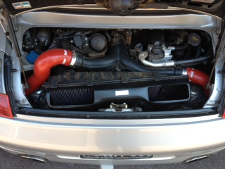

I just did my pipes using the Forge Motorsport kit. Nice price!
Their pipes come with what they call "jubilee clips" which we call hose pipe clamps, that clamp the pipe to the billet fittings.
I found that if you have this type of setup, you need to install the clamp right back as far as you can for the upper pipes where they pass through the firewall.
In hindsight it would have been easier to use the kind of clips that the samco hoses use, as the hose pipe clamp screw can foul the firewall if you put it too close to the billet fitting.
The right-hand upper hose was particularly difficult to get in the right place.
I also did not need to remove my wheels or the wheel arch lining, only jack up the car (use the centre support NOT the engine casing and put car on jack stands), so this saved a lot of time.
I also took the opportunity to install my Agengy Power dual flow air box too!
Here's the end result..
