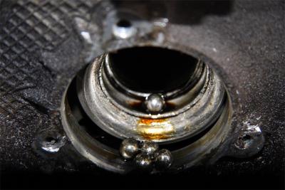

Hi
I have an update I have started dis assembling the car to take the engine out and whilst disassembling the exhaust system i have noticed alot of oil it can practically be poured out of it
does this help me lead to a diagnosis
Ross
I suggest you inspect the IMS brng for wear. I had one that sounded very similar and the brng was coming apart.
I have removed the ims bearing cover and this is what i found
Nothing left of the bearing
my next question is with the ims bearing disintegrating like this is there likely to be dmage to other areas of the engine.
