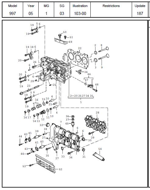

It is part 45 in this picture and it looks to be on
top of the motor.
I think it is part #996 606 203 00.
I will phone up Suset monday and look into the part.
Paul
The oil pressure gage on the dash reads 0 psi.
I tried looking for this part. Do you know what side
I should be looking on? Passenger or driver's side
USA car?
Paul
Oil pressure sender is on the right side (passenger side).
Many times the connector wire is loose, gets knocked off, or is broken.
If the wire and connector are intact then replace the sender unit. Replacement is the same as the 996 which has been covered here a few times.
