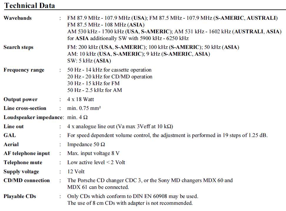

Does anyone have information regarding the CDR 220 radio as far as wattage output goes? I have the 10 speaker sysem and what appears to be an amplifier in the center inside the front hood. The speakers do not sau Bose on them. From all the pics I have seen there seems to have been a number of options available. Thank you, 2001 996 C2 Coupe.
