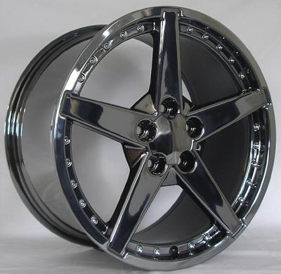

Nick, My car is white... Note that the black ones are not really black. They are called back chrome and they have a real unique look to them. Here is a black chrome wheel. I will try to take picture this weekend of my tail pipes.
