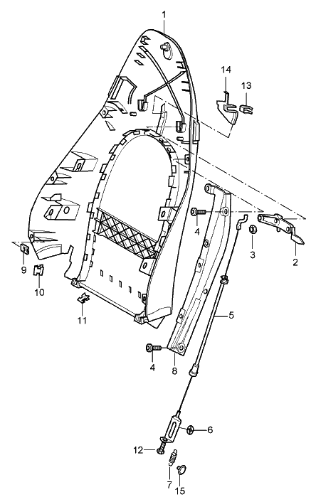

I also have tilt handles that do not work on my drivers seat. I just spent about an hour trying to figure out how to get my seats cushions apart.
on my MY99 standard issue seats the center back cushion unwraps at the bottom rear and unclips at the top. This, I thought, would be very helpful. It was not. It appears that the cable release mechanism is either on the outside of the shell, or inside a hollow on the outsides.
What I did finally discover at the end of my time with that #12 is a Torx bolt that can be adjusted. Why does this matter? because the way the release works is that it pulls UP on a pawl.
SO, I believe if you adjust the Torx bolt inward (viewed form the bottom of the seat) I believe that will help in correcting the problem. I will report once I find the appropriate torx driver and try it on my seats.
