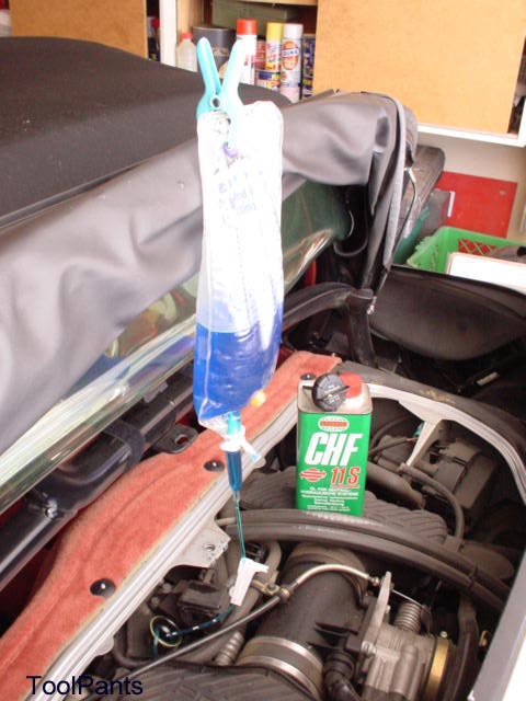

This is my joke picture because I have to top it up every few months. The blue stuff is dye in water. Pentosin has a green color to it.
