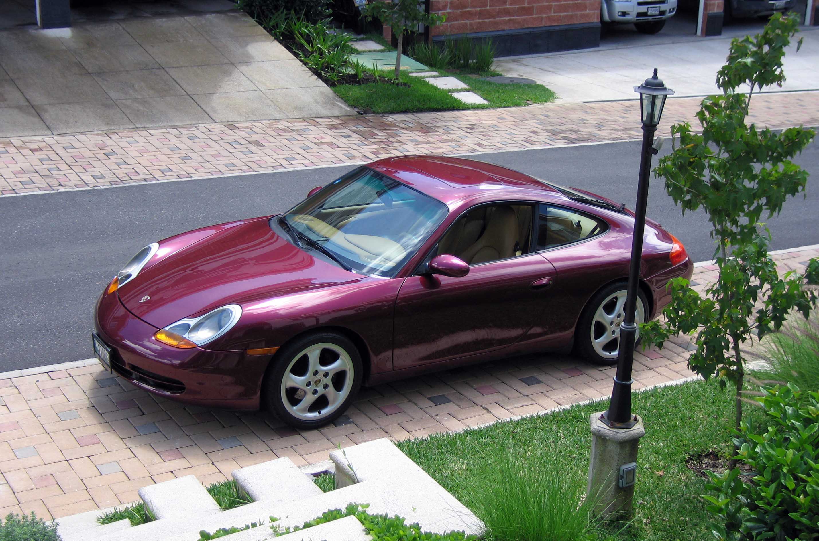

Just got my baby, a new to me Burgundy 911 Carrera C2 6 Speed with about 36,000 Miles. Model year is 1998 (RoW Version) comparable to a 1999 US vehicle.

Congratulations on your new to you baby. I really like that color combination.
