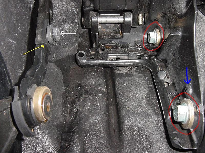

1. Put the top in the service mode (if you are not sure how to do this, it's in the owner's manual), and make sure the clamshell is at it highest position (45 degree angle, as far back as possible). Unlatch the black/gray vinyl apron from its two plastic retainers on the rear firewall and pop off the two tension cables from their steel balls at the base of the cables. Now, reaching under the B-pillar round black knuckle at its base, pull off the white plastic cups (maybe red plastic if yours have never been replaced) from the steel balls that they are pressed on to. If you have too much trouble popping those off, you can undo the 10mm bolt (with thick washer) from the middle of the connecting arm that leads to the white plastic cups on one end and the front of the V-lever on the rearmost end of it. Before you undo that bolt, mark the point where the two halves of the connect arm are joined so that you don't have to guess at the correct length later. I have attached a photo, where the white arrow shows the 10mm bolt with thick washer. The yellow arrow shows where you should mark the position of the two halves of the connecting arm. The red circles show two of the three large bolts that must be removed (see step #3 below) (Click on the photo for a better view).
