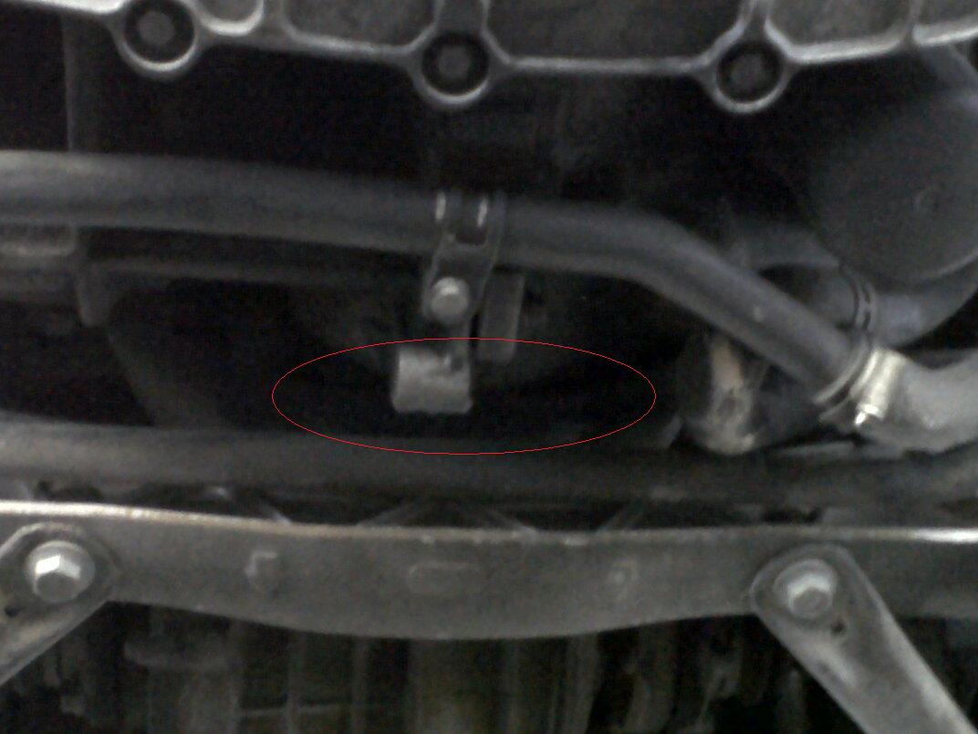

Hi there,
Did you manage to find out what the problem was? i seem to have the same problem on my 03 C4S.
i recently took my car to the Prosche Workshop for a Major Maintenance, they fixed some stuff along which was the Cardan Shaft as the bushings were totally worn out and they needed to be changed.
i went away on business for 10 days after i took delivery of the car, and when i came back i saw that the car has leaked 3 small droplets into my garage floor. the droplets were golden in color so i knew it's engine oil... i lifted the car up and can see that there are traces of a seep from where the engine is couple to the transmission, pictured below. assume it's the same place as where hugh has specified.
i'm taking it back to Porsche to see what caused this leak, as the car was perfect before i did the major service.
Any input is much appreciated.
Nehme
post-50282-0-53078600-1292668890_thumb.j
That is the typical RMS and IMS seal oil leak spot, an oil leak on top of the engine is also a possibility given the oil drips on the floor are pretty clean and the car was serviced recently. I would check it properly to make sure.
Thanks RFM, that sounds like a good idea because i haven't really checked if the leak is happening from the top somewhere.
any specific areas or hint as to where to look?
