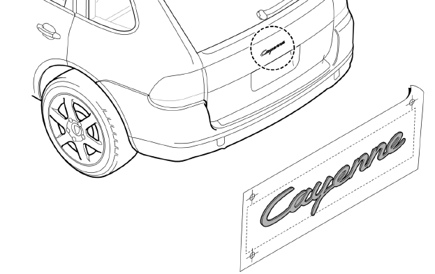

Does anyone have the measurements/instructions to install the new "Cayenne turbo" emblem? I just bought a 04 CTT and the previous owner removed his and i bought one to install install.

Mark the middle of the cover.
Apply an adhesive strip which can be labelled with dimension −A− approximately in the center of the cover, parallel to the edge of the cover.
Determine the center between the outer edges of the cover and mark on the adhesive strip.
Determine the center −M− between the outer edges of the license plate cover.
Align the logo using the adhesive tape marking and press it on firmly.
Pull the adhesive tape off the rear lid.
