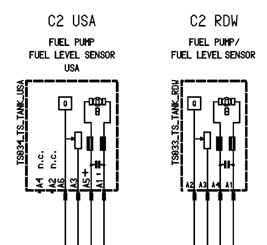

I imported the first Sport Classic to the US 3 months ago and still have not been able to drive it.
I need the following last part:
Read from conversion shop:
"The Porsche dealer says the harness part number 99761290300. I have
attached pictures of the components and we need the connector that is on the
harness. One is the combination fuel pump/fuel sending unit and the other
is the leak detection module (DMTL). We need the connector and the terminal
pins used inside the connector to attach the wires. If you have any
questions or need any more of a description please let me know.
See picture we need this connector other one has been located
please email me vramani@urbanliving.com or call 713-213-7241

Looks like only 4 of the 6 pins are used on US cars anyway (see diagram).
Perhaps you can move the pins in the existing connector to the proper slots for US cars?
