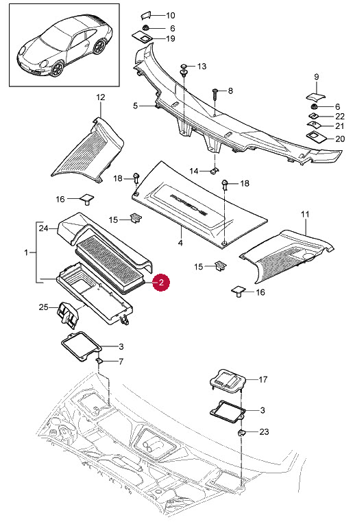

Item 2 is your pollen filter. It does the same process as the Mercedes filter.
hi loren, great to hear from you. thanks for indicating that however i wonder how the air in recirculation mode gets filtered before enterring the evap? from the diagram i can see that the pollen filter cleans air coming from the outside - recirculation mode is off. Does it also clean the air in Recirc mode? merc has 3 seperate filters - one for outside air(similar to item 3 in diagram provided) - recirc off, one for inside air-recirc mode on, and one charcoal filter for removing smell from air coming from either source...
from the way it looks on the diagram, the item 2 is exposed to the outside air and is used only when air from the outside is brought in to cabin

The pollen filter is only for outside air because the flap under the filter is closed when REC. is engaged. Anyway, the filter should be replaced on the regular maintenance schedule because he always is exposed to the outside air, independent of the AC/HEATER/VENT. system actual position. I would further follow up ADias counsel concerns the REC. position.
