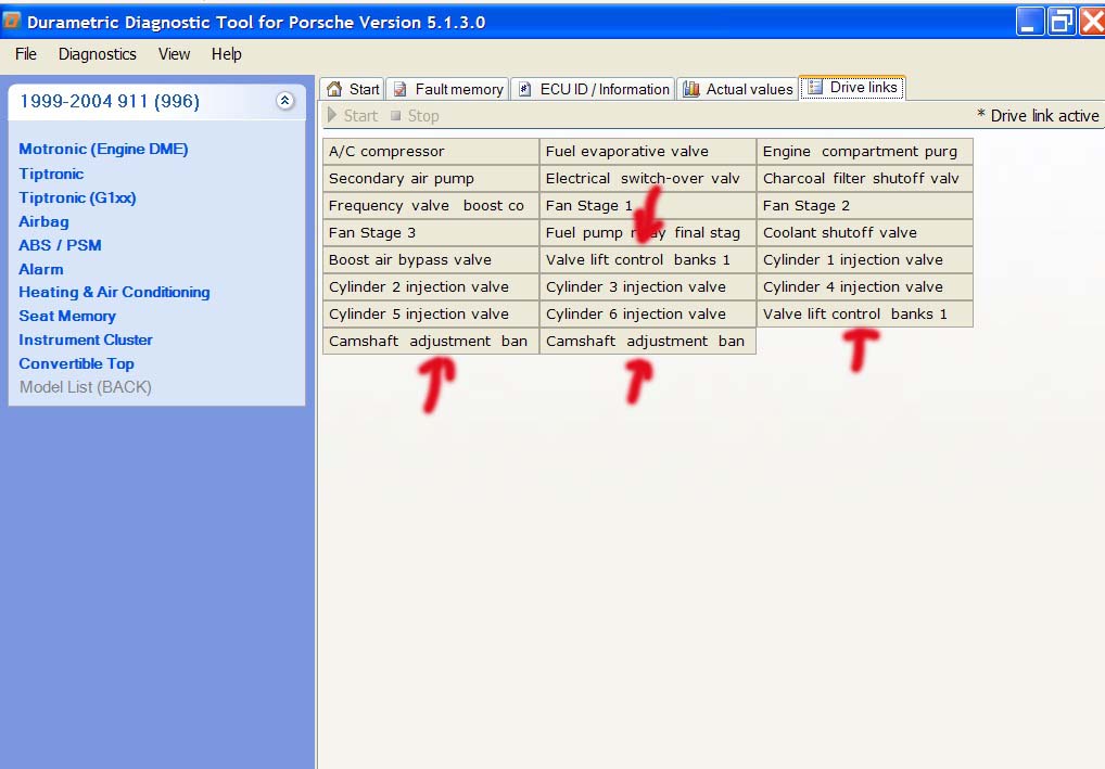

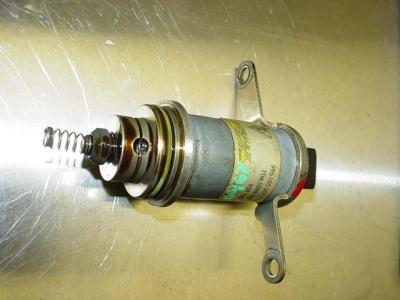

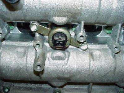

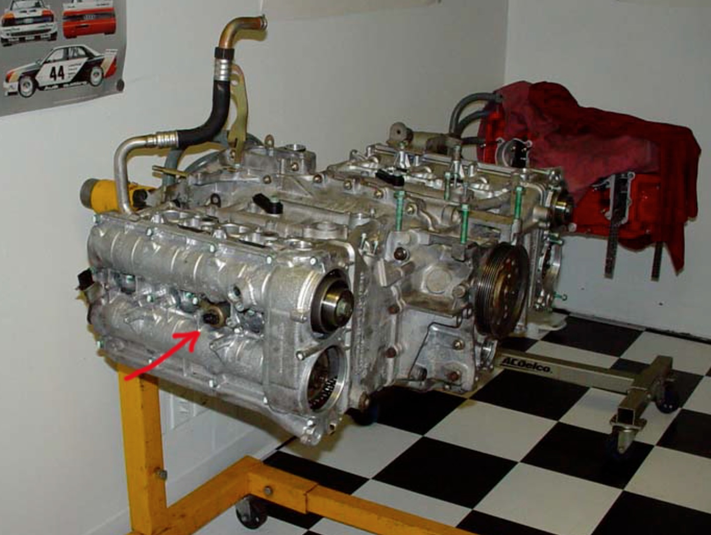

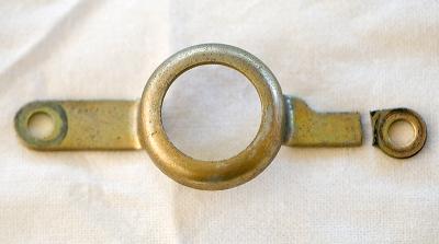

This software got a "drive link" function that aloud you to test both banks of the vario cam system. There is a total of 4 solenoid that control oil pressure to the system. Two per banks. two for the valve opening, 3mm or 11 mm. The other two are for the cam advance 0 to 40 degrees. With Durametric you can simulate a signal to one of those solenoid and if the engine suddenly hesitate after triggering the function you know the signal is functioning. There is another item you can look at is the solenoid bracket. Porsche came out with a TSB to inspect the solenoid bracket. This solenoid is located on each bank about the middle of the head and are used for valve opening. If the bracket is broken the solenoid come out of his seat and the oil pressure is not going to the system anymore.
