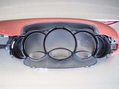

This is a 2000 2.7 with a 996 cluster we saw at a recent tech session.

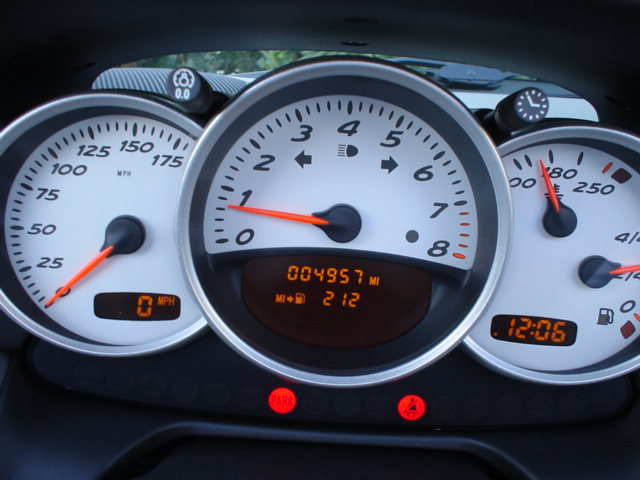

In 2002 on the 996 and Boxster Porsche introduced a cluster with a dot matrix center display for cars with the OBC option. If the car does not have the option then it is a LCD display just like a 2001, or just like your 2003 without the OBC option. If you use a non OBC 996 cluster and retrofit the OBC then what you will see will look like a 2001 Boxster with the OBC option. There is nothing wrong with this as you will have all the OBC functions of a 2001 with the OBC option. This sort of explains it. http://www.brackenrig.net/OBC_Hack.htm With the part number from your 996 cluster I can look it up and determine if it has the dot matrix display from the part number list as it will show 659 after the part number as 659 is the option code for the OBC. If it does not have 659 after the part number then it is the standard cluster which, as I said, will look like a 2001 once you do the retrofit.
The pic is a 2003 Boxster S I did the retrofit on 2 years ago with the non OBC cluster. You can see the 212 miles remaining in the gas tank is a LCD display, rather than a dot matrix display you see in your owners manual.

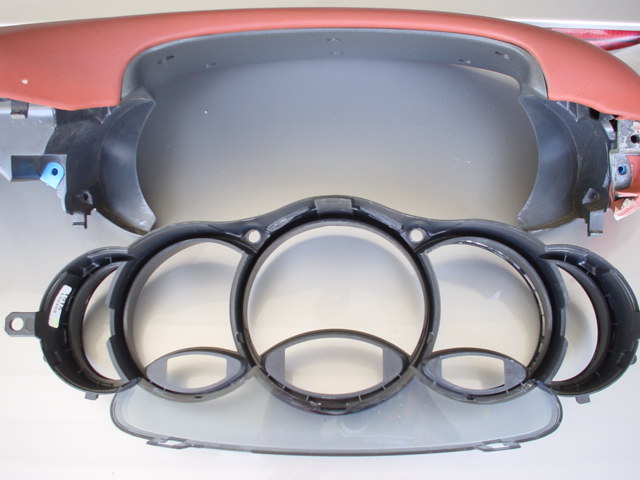

You can trim the Boxster surround to fit the 996 cluster. That is what was done in the prior picture of the 2000 2.7. That is what I was going to do with my car since I have Boxster red leather and a 996 red leather cap is very expensive.
Here I was measuring where I needed to cut my Boxster surround using the removed front of the 996 cluster as a pattern. Then I thought I sould make sure the ebay 996 cluster worked before I cut my Boxster surround. When I plugged in the 996 cluster it had the defective middle display. So that was the end of the project until I find another 996 cluster.
