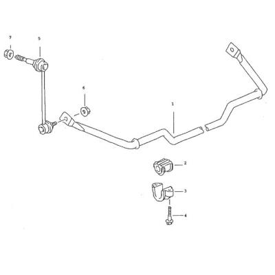

  20. These are the boxster diagrams. The 996 should be similar. When people talk about lubing bushings I have always assumed that they mean item 2 in the drawings as these are the rubber parts that secure the bar to the body.

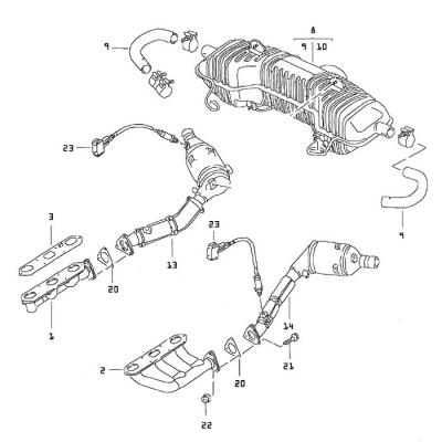

  21. Yes the one between the exhaust manifold and the catalytic converter. You may also just want to check to see if the connector is loose first and/or that the connection is clean.
  22. P0133 is "Aging of Oxygen Sensor Ahead of the Three way catalytic converter (cylinders 1 to 3)". P1275 is "Aging of Oxygen Sensor Ahead of the Three way catalytic converter (cylinders 1 to 3)" - Below lower limit. I interpret this as P0133 you have a sensor problem. P1275 by the way it seems to be reading low.
  23. I believe it is the clutch line.
  24. Under the rear of the car. Locate the exhaust manifold, follow the pipes toward the muffler. Between the manifold and the exhaust are the catalytic convertors. On either side of the catalytic converter are the O2 sensors. Your code indicates the sensor between the exhaust manifold and the catalytic convertor is faulty. The O2 sensors are numbered 23 in the attached picture. The picture only shows two of the four O2 sensors that are present.
  25. The manual says this is the front O2 sensor bank 1. That is the passenger side. I would swap the O2 sensors side to side and see if the problem moves with the sensor. If it does then replace.
