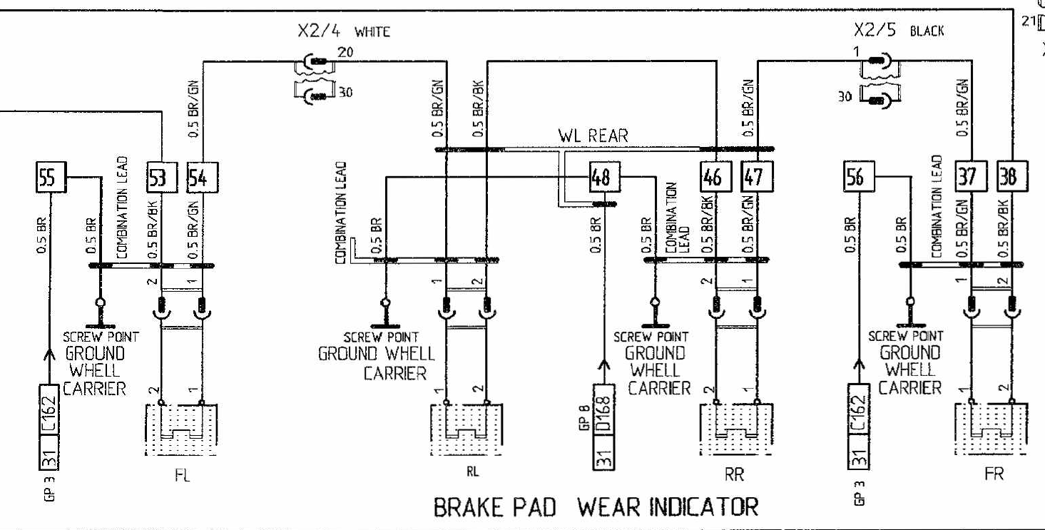

On my 99 996 Coupe, The "BREAK WEAR" light on the dash intermittently lights up and may stay on for a while. Suspecting a problem with pad wear, I pulled all 4 wheels and find that the rear pads are new and the fronts still have 70% remaining. There's no apparent damage to a pad sensor wire but I suspect a bad sensor. Any help on determining which one or what else it might be?

You have at least one open or intermittent sensor or wire.
Inspect each of them - test them with an ohm meter. Any open in the circuit will turn the light on.
I have a similar problem on my car. Brake wear light is on all the time. Tested all the sensors, and they all tested good. Then replaced all the sensors, still have the light. I am thinking that I have a fault in one of the other wires/harness' for the system. The wheel sensors and the brake wear sensors each connect into a common harness. I don't think you can isolate which wheel is showing the fault.
Yes, they are all in series so you need to disconnect them one a time to test.
Even PST2 or PIWIS will only tell you "one is open" - it can't tell which one.
