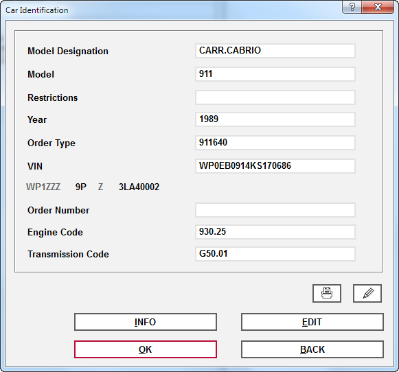

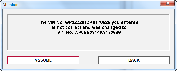

1989 911 with 2 VINs
jrusher
In the '80s, when the standardized 17 digit VIN was first implemented, the chassis were built before the destination of the car was known and a generic VIN was stamped on the chassis for its identification using filler codes (ZZZ) in positions 4-6. If the car didn't come to North America, after the car was completed, the actual VIN placed on the windshield post/door jam sticker would match that on the chassis and contain the ZZZ filler characters. On cars destined for North America the VIN had to meet US standards and thus the ZZZ codes were filled in on the windshield post number/door jam sticker(the actual VIN).
-Todd
