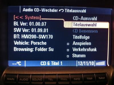

Hi, looking to see if someone can help with updating the firmware on my mobridge ABT2010. The mobridge website has some instructions but I can't get their update wizard to talk via bluetooth to my mobridge. So I am attempting to use the SD route instead. However they have 2 firmware files - one for a gen 1 and one for a gen 2. Now I believe this refers to generation of mobridge device. Does anybody know how to tell if my mobridge is a gen 1 or gen 2? Anybody have some experience with how to make this work reliably? I've put the correct config file on the SD card (generated via the wizard) and then put both gen1 and gen2 files on the card. I've tried getting some SW load to happen with a variety of plug the card in, turn the car on and off combinations but seem to be getting nowhere ...
Added the SW version screen shot to it hoping that gives a clue to what the right procedure is.

Sorry to bump this post, but can anyone advise how to determine whether you have a gen 1 or gen 2 bluetooth on the mobridge ABT2010?
My details are BL Version 01.01.01 SW Ver 01.09.04 BT: HW200-SW321
