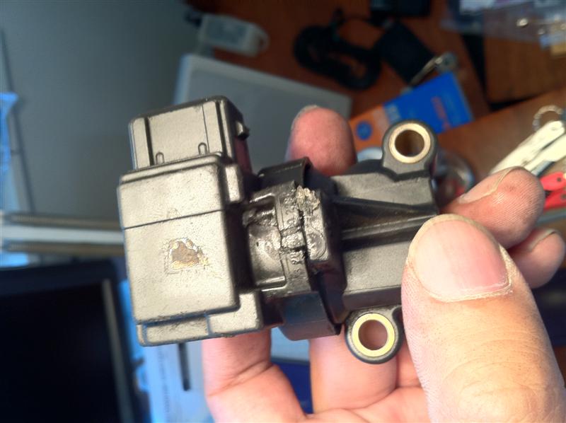

When I took out the TB and IVC, there wasn't much carbon build-up, which I sprayed out with degreaser. But I did notice a small crack in the IVC. Don't know how much this affected things. I tried to seal it with some super glue yesterday, don't know how good a job I did with it either because the crack was still visible after the glue sank in.
But today, two warm starts and the car has been fine. So maybe it was the TB or the IVC afterall. But I don't know if it was the cracked IVC that I might have managed to save with some super glue. Wouldn't that be a story if true? IVC costs like $200-300 to replace. Super glue = 40 cents. :)
