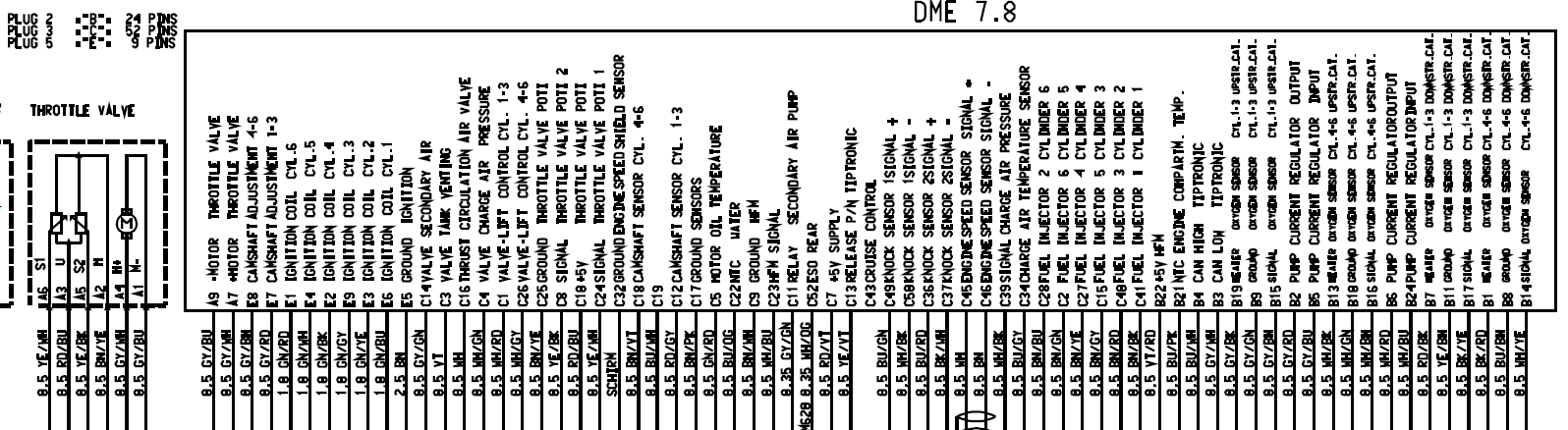

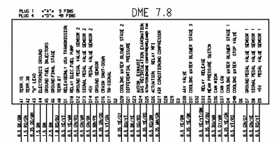

I have a problem. This problem HKS EVC 6. More precisely сonnection to Porsche DME 7.8. (996turbo, tiptronic s, 2001)
I long searched pinouts & plug diagram's but haven't found. To me very necessary two DME PIN. 1.Engines RPM 2.Throttle (pedal) position sensor. DME has 5 connectors and much PIN where to search ? Or at least give "pinouts & plug diagram" for Porsche Motronic 7.8.1. My E-Mail: Freaked911@hotmail.com thanks...
but... Certainly, it is better if tell very in detail
