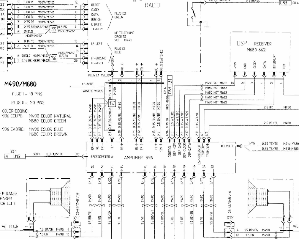

Hi Everyone,
I am looking at installing an amp to power a set of subs for my 2000 996. I have the Hi-Fi set up and will be leaving in the stock head unit and amp in. My question is, can I use the wires that currently go to the door speakers as a high level input for the sub amp? Also what color are those wires? I'd like to tap into them in the trunk off of the stock amp output.
